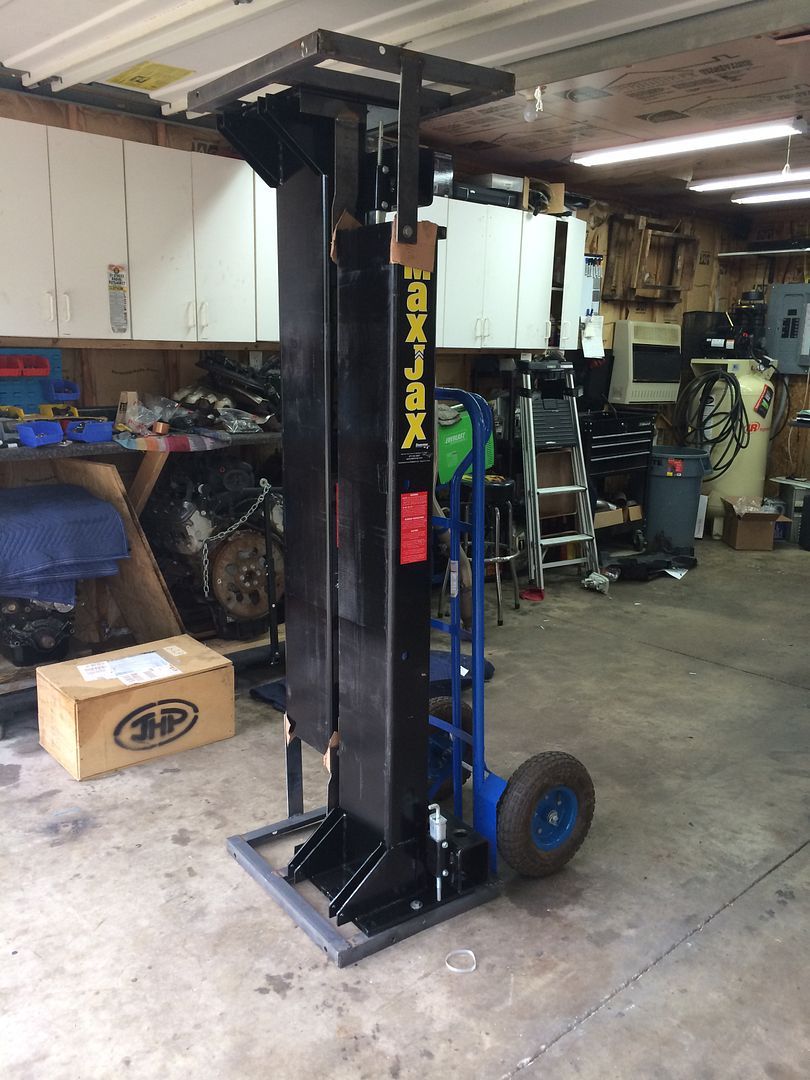

A few weeks ago I was looking for opinions on a MaxJax lift. After all I read online I decided to pull the trigger on one. Surprisingly, I ordered it from Summit, they had it in stock and shipped the same day (a wednesday) - To add to the surprise, they delivered it that same week on Friday.

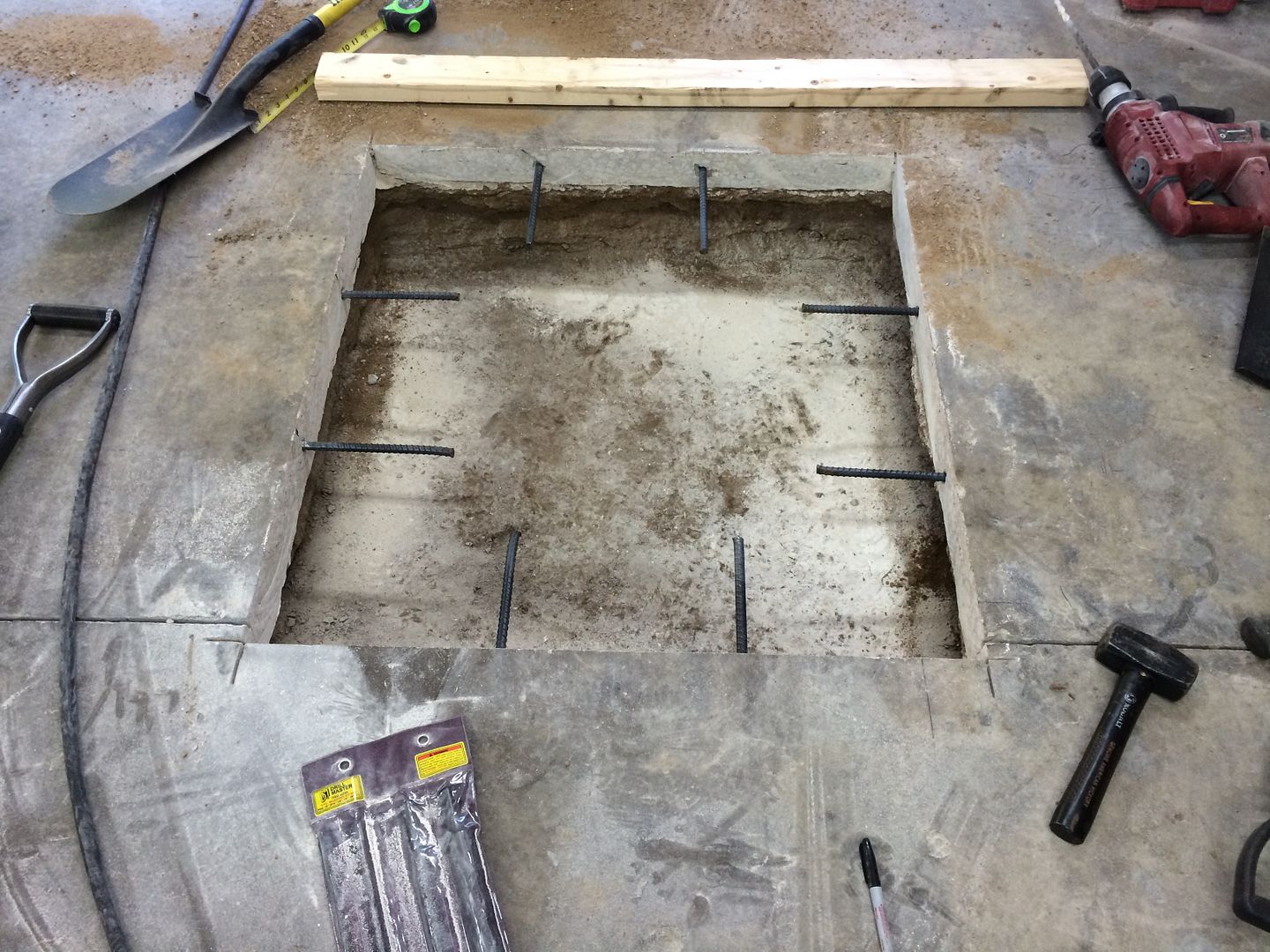

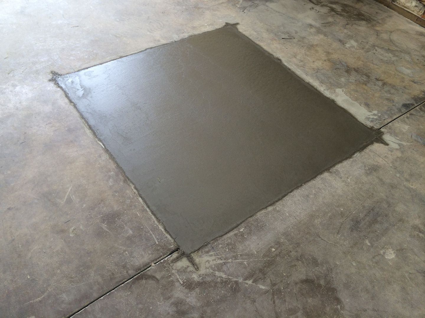

My initial measurements told me that the garage slab was thick enough for the anchors, however after drilling one side, I found out that my West facing wall was not deep enough. I had to cut out a portion of concrete, dig it deeper, refill, and let it cure

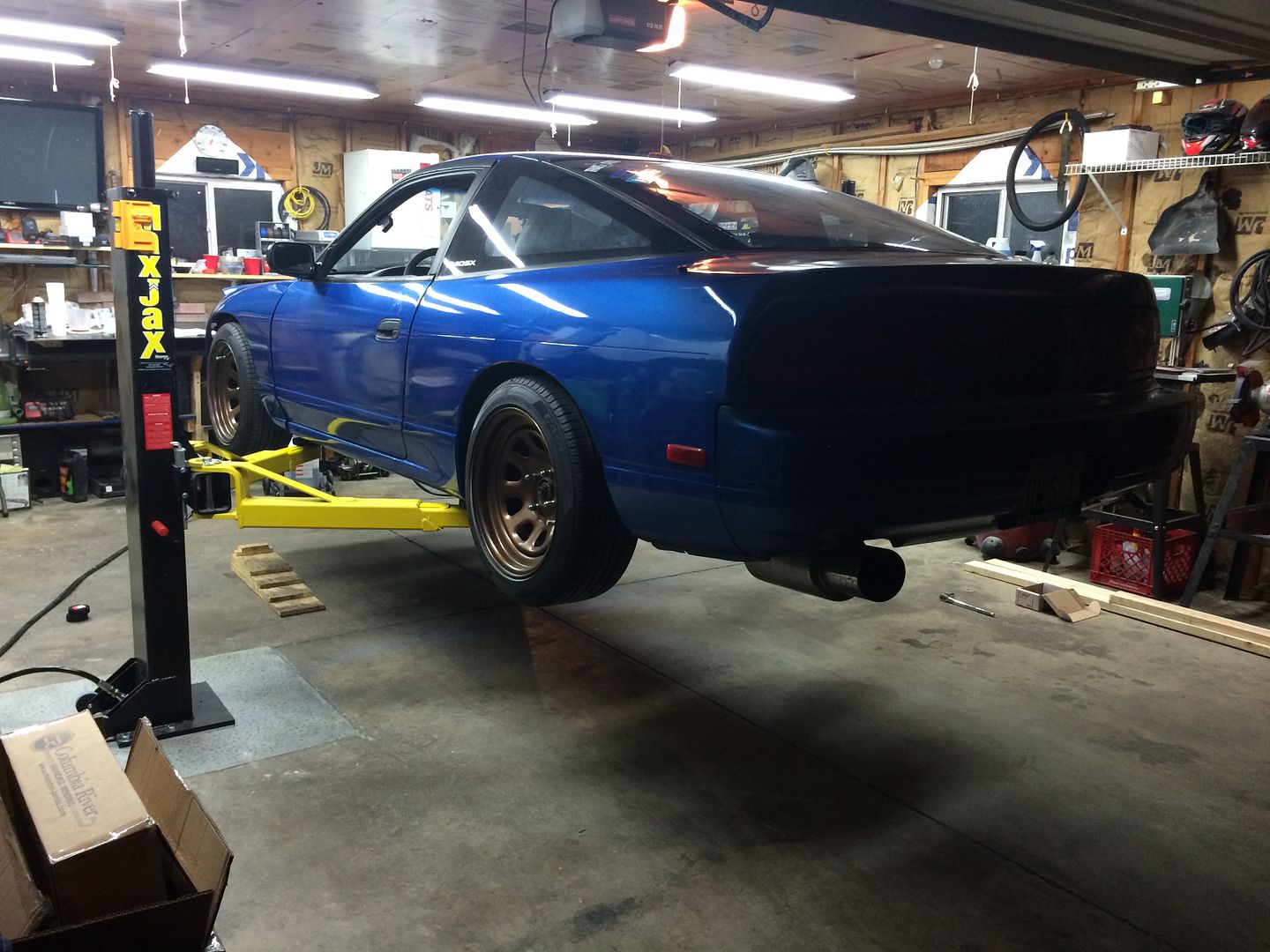

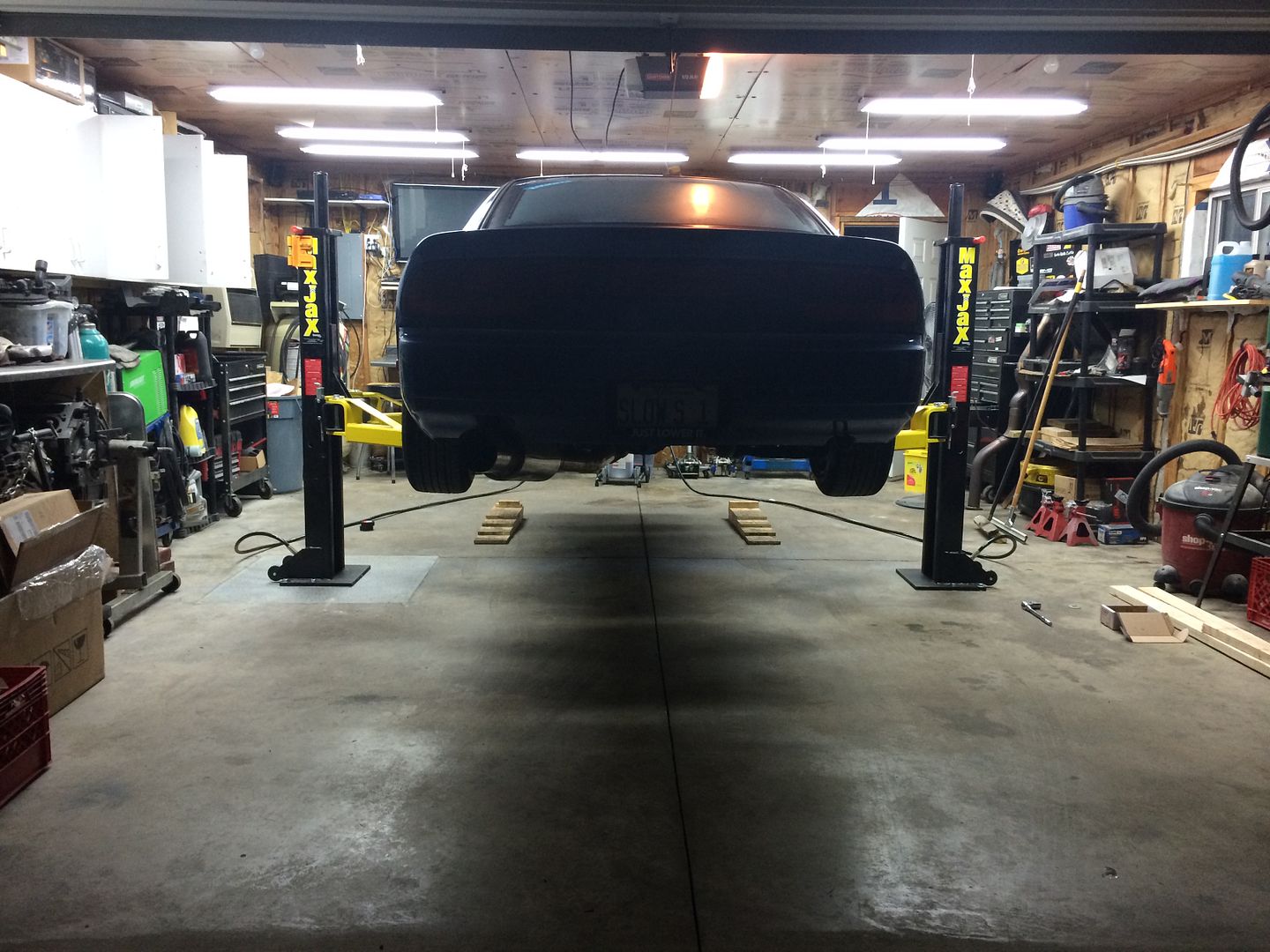

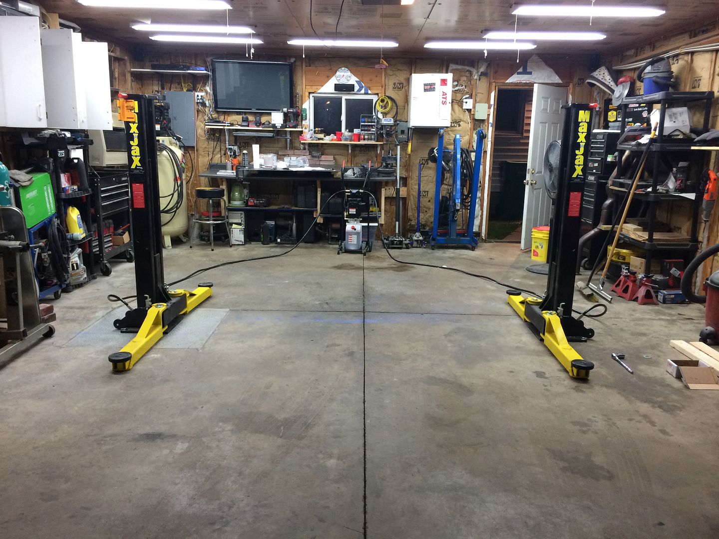

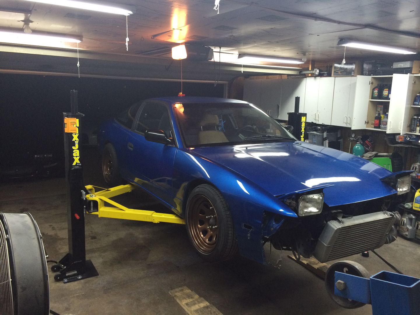

Fast forward a week later, I got the system all installed and the hydraulics bled out tonight. I decided to do a test run on a "beater" 240 that was sitting around before tossing my GTR up on it.
So far so good. It looks like it will give plenty of clearance for what I do in my garage and it'll tear down / set back up in ~15 minutes for when I want it out of the way. Looking forward to putting it to use!
